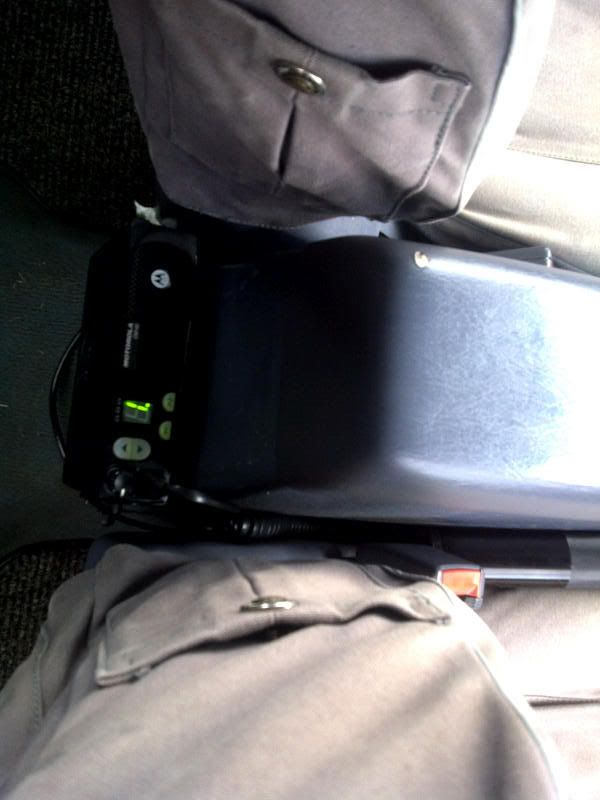

Sun Apr 19, 2009 10:48 am
Ok... let's try again... 3G file uploads are messing me around again!
I installed my radio yesterday, there seems to pattern here...
I made a steel plate to mount the plastic mount on top of.
B :thumbup:
Dadz Toy BFI

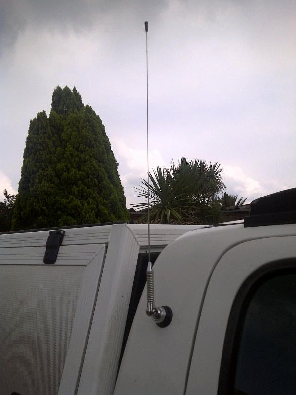

Sun Apr 19, 2009 11:17 am
That's neat Bretton, think I'll do the same (mine's secured with duct tape) :roll: :wink:
Ps... where did you mount your aerial and is it a compact or a full length :?: )
Mr_B
Posts: 7324
Joined: Fri Oct 12, 2007 2:38 pm
Vehicle: Honda Jazz
Real Name: Bretton
Sun Apr 19, 2009 11:23 am
Dadz Toy BFI wrote:That's neat Bretton, think I'll do the same (mine's secured with duct tape) :roll: :wink:
Aerial in mounted on the roll bar... the higher the better... it's a Webb full whip type...
My lux looks like a full scale remote control car! I'll post pics of the extended shackles soon as well...
B :thumbup:

Mon Apr 20, 2009 7:04 am
snipes wrote: I made a steel plate to mount the plastic mount on top of.
B :thumbup:
Bretton, you do know you didn't have to remove the door handle to install the radio in between the seats :twisted: :twisted:
or was that just so you knew you had a handle on things :?: :lol:

We had the VHF radios fitted at the begining of the month, new Motorola CM140 models with quater wave antenna (Zara 60) as F_D proposed. :thumbup:
Here the radio is fitted to the back of the centre console with the radio bracket
The antenna cut to quater wave

Tue Feb 22, 2011 2:46 pm
Netjies Henk, maar jou radio is oppi verkeerde kanaal.... :tease: :tease: :tease:
Hilux01
Posts: 594
Joined: Tue Aug 26, 2008 11:54 am
Town: Secunda
Vehicle: Toyota Hilux 3.0D4-D dc 4x4
Real Name: Henk
Club VHF Licence: X85
Tue Feb 22, 2011 2:52 pm
Mark :lol:
Not a big problem, this model has a little button, plenty of channels to choose from :lmao:

Tue Feb 22, 2011 4:35 pm
Handy to have your radio set to also be able to scan through all the channels :thumbup:
Posts: 12733
Tue Feb 22, 2011 8:28 pm
Nice job, Henk! I've saved the antenna pic to use as an example ;)
Tue Feb 22, 2011 8:50 pm
Family_Dog wrote:Nice job, Henk! I've saved the antenna pic to use as an example ;)
Eric......is that allowed.... :eh:

Tue Feb 22, 2011 9:18 pm
Mark still having a challenge to get the scan function working, any advise? :oops:
Eric, no problem! :thumbup:
2013 Toyota Hilux 3.0D4-D dc 4x4
Bush Lapa Miskruier 810
Gerbers Alu Canopy
ORRA Call Sign: X85
Tue Feb 22, 2011 9:27 pm
Hilux01 wrote:Mark still having a challenge to get the scan function working, any advise? :oops:
Henk, not sure how the Moto works...sorry, perhaps the radio guru can help you out here :?:
Hilux01
Posts: 594
Town: Secunda
Real Name: Henk
Tue Feb 22, 2011 9:38 pm
Thanks Mark
Eric any advise?
Gerbers Alu Canopy
ORRA Call Sign: X85
Posts: 12733
Wed Feb 23, 2011 6:46 am
Scanning needs to be activated when the radio is initially programmed. Most dealers (ourselves included) prefer not to activate this at it is not really necessary - has more nuisance value than anything else. In general, ORRA 1 is always the "Calling" channel (remember Ch 19 in the good ol' (bad ol'?) CB days. From there, one would pick a channel.
The only instance that we do activate scanning is for the Farmer's Mid Band (Burg. B) radios, where channel 2 is purely used as a calling channel and then any one (and only one) of the channels 3 - 8 is used as a "werks kanaal", or talk channel. In this case we do activate scanning on Ch 2 and the specific talk channel only, i.e. in our area it would be channels 2 & 4 only. We do not scan the other channels at all.

Question - where is the best place to mount the aerial. I was thinking on the left hand side front fender close to the windscreen.
Posts: 12733
Wed Feb 23, 2011 4:50 pm
No!! Either on the roof, or on the rear (B or C) pillar, as high as feasible. Hope you can now see Henk's pic, that is how it ashould be done.
Thanx F_D
I see a lot of guys mount the arial on the front bullbar, is this not similar to mounting it onto the front fender.
I don't particually want to drill into my C pillar and feel that a fender is easier to replace / repair.
What would the issues be in fitting the arial to the fender compared to the C pillar / roof / bullbar??

Fri Feb 25, 2011 1:54 pm
[/quote]
i mounted mine on the front right fender.

Fri Feb 25, 2011 3:45 pm
Hi Lane, without any issues / comprimise on reception / coverage distance / etc???
If I look at it one would loose about 1/2m in height compared to a C pillar mount and less than 1m on a roof mount.
Would that make a BIG difference on the reception?
Posts: 12733
Fri Feb 25, 2011 8:15 pm
Mounting the antenna anywhere lower than roof height is a compromise. The bullbar is a convenient place to mount the antenna, but transmission will be somewhat directional. Ditto the fender mount. But if you are not worried about long-distance communications and only feel the need for convoy communications, it is acceptable.
Lane, if you have both the current ORRA frequencies programmed into your radio, you need to fit a quarter-wave antenna.
