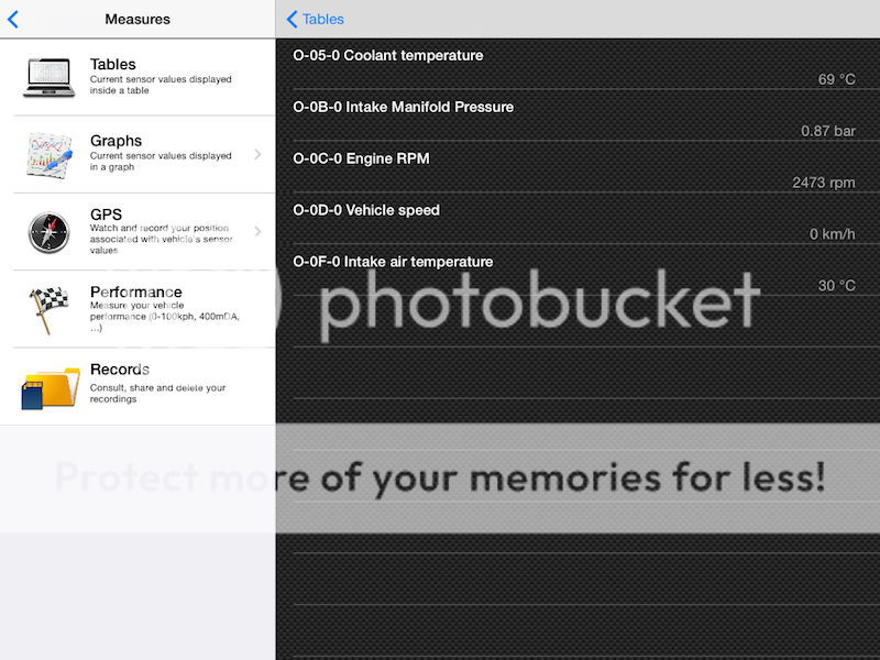

JohanW
Posts: 471
Joined: Sat Nov 17, 2012 9:56 pm
Town: Strand
Vehicle: '09 Hilux 3.0 D4D 4x4 AT
Thu Oct 01, 2015 11:08 pm
Muntu, check that turbo. It doesn't seem to be boosting correctly. So your intake manifold pressure is low up to below 3000 which leads to incomplete combustion also known as overfuelling. As you go above 3000 the little boost your turbo creates is just enough to stop the overfuelling and combust better. You can take off the hot side of the turbo and check for oil. A thin film is fine, runny oil everywhere is not. To recon the turbo with new seals is about R1800 excl labour. Did my turbo a few months back.
The kz-te has a obd2 port just above your left foot under the dash. You can read the intake manifold pressure from it. it should be about 160-180 kpa from 2500-3000rpm.

Thanks Johan, I've got an OBD2 reader, I'll check what pressures I'm getting. She is definitely getting faster and more powerful. Just done 10,000KM's since last overhaul so my guess is the rings are finally settling a bit. The boost pipe (to the intercooler and to the inlet manifold) are both clean. A tiny film of oil.
I've got a brand new spare turbo sitting in my garage, should the turbo prove to be a problem, I'll change it, but there is no lack of boost while driving it.

Lo Johan,
SAC did tell me before that my current turbo is under performing, the results below. I bought a new original turbo from SAC and that one put's out a max of 1.6....That turbo I kept as a spare. Could it be that there's a loss in pressure due to the SAC intercooler conversion?

Muntu, from those pics I can see that your turbo is doing sweet boggerol. Its not creating any boost.
BUT it will also look like that if you did the test at standstill. Go find a hill and redo the test.

It was done static... Can't drive and take screenshots. I'll see if I can do the test again while actually driving.
