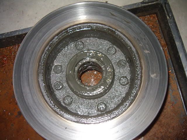

For the last few months, yes it has already been a while now, (but I do not drive my 4x4 everyday, it stands in the garage at home and then I sometimes use it on the weekend) I have been smelling this buint oil smell, had a look in the engine bay a few times to see if I could see any oil leaking from the engine and underneath the vehicle to see if any oil was leaking onto the exhaust pipe, thinking along the lines that maybe the engine was getting on in it's age, yes it does smoke slightly but not enough to warrant a burnt oil smell like this, however...........
The other day on the way home from out 4x4ing, I noticed that the brakes were not too great, yes I do know that the front brake pads are getting low, but were still within their wear limit, I know that the one front wheel nut was broken and was going to tackle it the next time that I changed the swevil hub seals, because you have to remove the bearing hub and disc to replace the wheel studs.
Well when I got home, I noticed that there was excessive smoke pouring out from the right front wheel arch, thought to myself OH @#$#$@
Anyway popped the bonnet and saw that there was no oil leaking or much smoke in that area, I then felt the front locking hub for warmth, it did ot feel too hot, but this is when I noticed that there was smoke pouring out from the front brake caliper area, with the help of a lead light, I saw that the outer brake disc backing plate and the brake disc had some black looking grease on it, thus Bingo here was the problem, now I can change the broken front wheel nut at the same time :)
This photo above shows just how much grease was leaking onto the hot brake disc and thus the smoke oily smell.

Tue Feb 12, 2008 8:43 pm
Photo showing my dirty fingers :lol: actually the wheel stud, note the anti corrosive paste on the shank
New bearing with grease sitting in position, now you have to fit the seal, the dished part of the seal goes towards the bearing, the flat side must be tapped in so that the flat side is flush with the bearing hub
