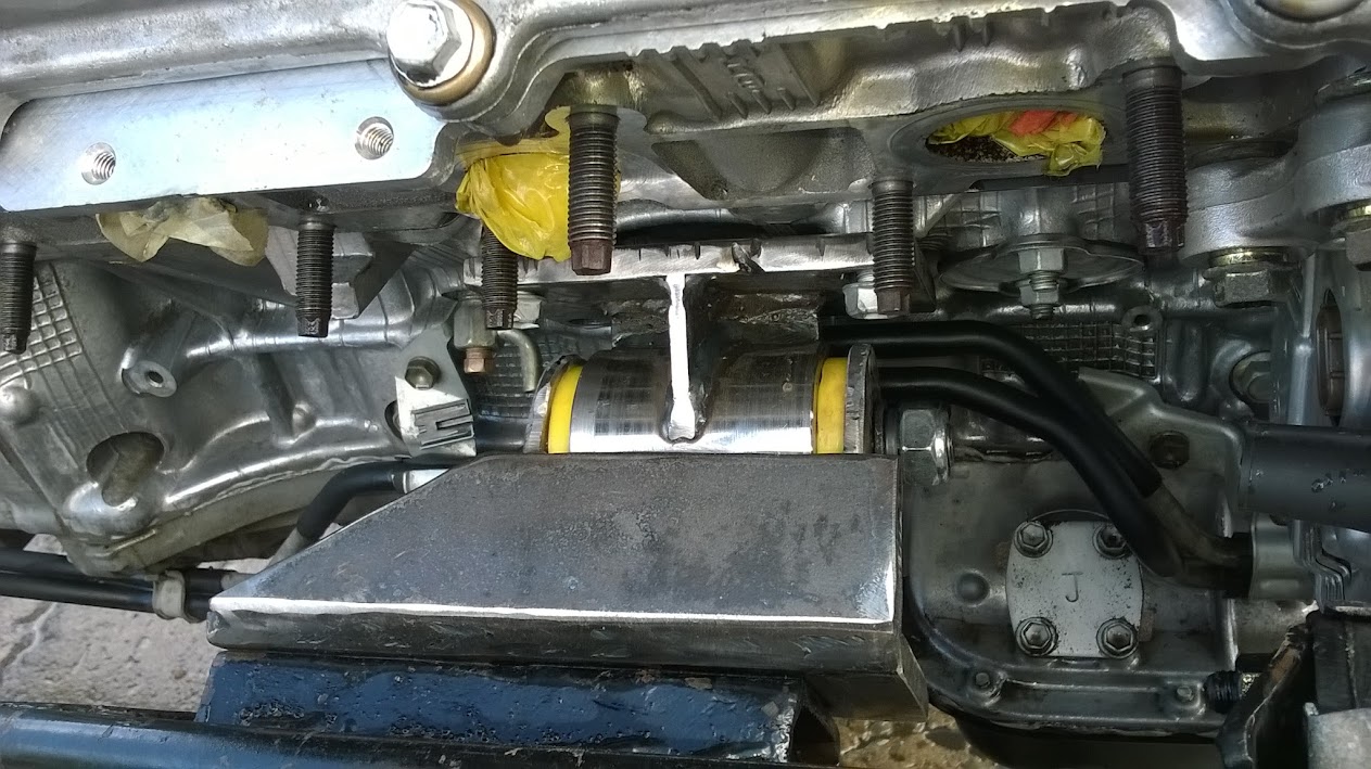

Thu Oct 29, 2015 12:32 pm
Some more progress
Engine mounts done.
Starter checked, 100% condition, probably only 15% of is life gone :D:
New battery cable attached to starter
Wiring harness removed.
Serious cleaning done.
Image Link Broken
Image Link Broken
Image Link Broken
Image Link Broken
Image Link Broken
Image Link Broken
Image Link Broken
Image Link Broken
Image Link Broken
Image Link Broken
Engine is in the chassis
:celebrate:
Image Link BrokenImage Link BrokenImage Link Broken

Earth cable from motor to chassis?
Baie netjiese mounts daardie. :thumbup:

Johan :thumbup: on the "to do" list.
It's got a little stump dangling near the oil filter at the moment. Cable is in the office, awaiting some decent lugs and a proper crimping tool.
I was also told to run an earth cable from both cylinder heads to the chassis. Even if it's too much I will do. Got the T shirt and worn it out regarding earth cables :oops:

Yup earth die heads & blok.

Looks great just keep in mind those shackle bushes don't like the heat so much caused by the manifolds . and solder wires as far as you can before using lugs and a crimping tool...

Juan, thanks for the heat tip. :thumbup: Will make a heat shield once I have my manifold made. Regarding the soldering, I normally do both, Crimp it into the big lugs and then add the solder. I saw the OEM lug that came off the starter was done the same way, crimped and soldered!
Guys, I appreciate any tips on what you see or think :clap: Don't be shy, believe me it make me think and does influence the build tremendously. It helps me not having to pay all the school fees!
Those engine mounts are inspired from what I was shown on this forum already. I surf a lot and find ideas and facts all over the show on the forum mostly but also elsewhere.

Quick question, how do you know if the incline the motor is sitting on is correct or not?
I know it should be at an angle, but how do you know what will work and what not?

I am a little more than familiar with that drive shaft vid :mrgreen: got a lifted land cruiser (X2) that used to Grrrrr because of incorrect prop shaft angles.
To start with the SFA flanges on the prop are not parallel. Mr yota provided for a double cardan to sort that out for the front prop . As long as I stay within those original angles i will be ok.
I first mounted the gearbox before i did the engine. The pictures I posted on your and my thread shows that the box is tilted towards the rear or put in another way "the ass end is hanging lower" at an angle. That angle is identical to how it was mounted originally. After bolting down the t/box i dropped the engine untill the angle was perfec to as the t/ box would have been if it sat on the original position on the gearbox crossmember. Hope this makes sense :blink:. That extension plate was welded flat onto the cross member so the angle cannot be anything but what it used to be.
And that being the reason I had to strip the manifolds off to get the motor to drop between the chassis rails.

Kry die engine so horisontaal as moontlik, miskien kyk of jy die gearbox&transfer case kan space op die crossmember. Dis sodat die oile vlak in die engine kan reg wees.

Dis lekker as mens dit so topless kan doen :D:
Ek laaik jou enjin mountings, dis 'n goeie idee.
Posts: 28069
Mon Nov 09, 2015 8:20 am
pietpetoors wrote:Dis lekker as mens dit so topless kan doen :D:
Hmmmmm ..... might be too hard / rigid. You might well find that you get excessive motor vibration transferred into the chassis. :think:
Otherwise looking good so far! :thumbup:

Regarding the engine mounts, I had the same thought when I started the build BUT I have some tricks to make those softer and if that fails then I will buy the genuine rubber bushes to go in there and if they are then too hard I will further manipulate them to make them softer. Those bushes are Land Cruiser 79 pick up rear spring shackle bushes.
There are two bushes in each mount, drilling holes in them lengthways will be the first step. Cutting them shorter is the second step. I am sure I will find a happy medium somewhere. Have seen this type of setup elsewhere also and it works.
Posts: 10188
ORRA Call Sign: X27
Mon Nov 09, 2015 9:22 am
Some of the Golfs and Polos had something similar as front engine mountings, they just a bit bigger, but think they will be softer. Think yours are way stronger.

Daar is geen vibrasie op die mounts. Bosbeer het geen.

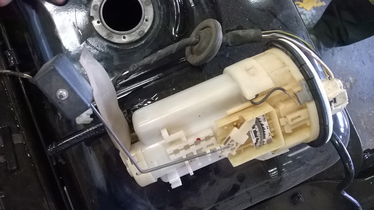

Gha, I went shopping, en toe vat ek raak. :yahoo:
I want to run OEM type setup as far as possible. Part of this is running the oem pump for the 1UZ from inside the fuel tank.
So I went a hunting in the scrap yard and found the housing that houses the fuel pump for a corolla (4ZZ engine)
It looked to be the right depth! and it is excactly right :D:
I know I have to increase the hole size in the tank but thats very doable.
Once opened I found the fuel pump inside to be the exact same dimensions as the one I bought that is OEM for the 1UZ engine. Plug and play !!!!
:celebrate:
Now to cut the hole bigger and make the housing retainer, where's my Turner :boss:
